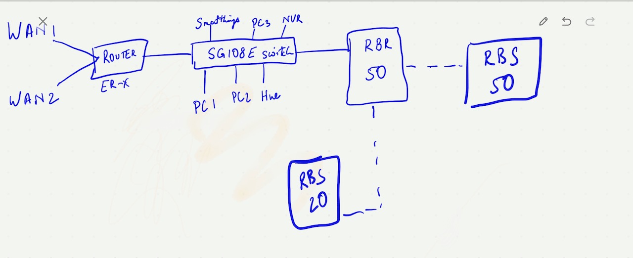

Rough topology
WAN -> Router -> Switch (SG108E) -> RBR50
The switch has other wired devices on it while the RBS20 and RBR50 have a non-daisy-chain link to the RBR50

    Could you please make a simple drawing showing exactly how the RBS50 and RBS20 connect to the RBR50?
    Are they wired directly to RBR50 LAN ports, or do either of them connect through the switch?

      Hopefully this makes more sense (See attached drawing).
      Testing just now after a full reset - For example, PC 1 can ping RBS20 but not RBS50
      However if I telnet into any of RBS20, RBS50 or RBR50 , they can all ping each other just fine
