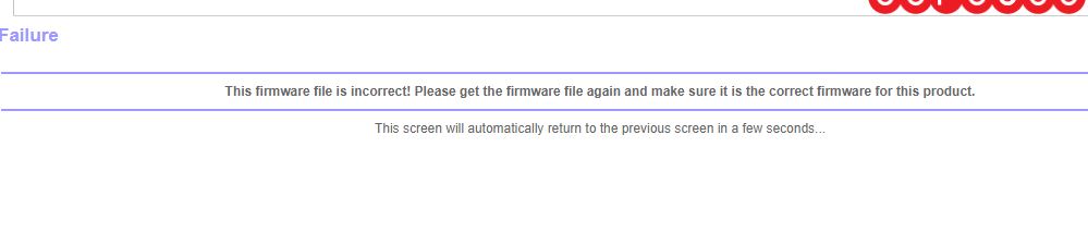

      HI,
      I tried the method of using the intermediate software but the Orbi says the f/w is incorrect. (attached).

    I would apply v212 then v2.5.1.16 to the RBR. You should be able to directy update to v16 on the RBS with out the v212. Update the RBS first.
