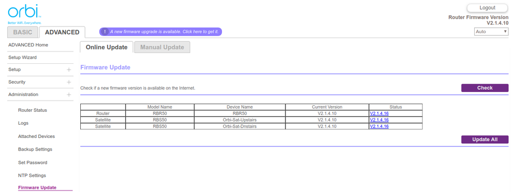

When I first bought them and set them up the system notified me that there was firmware update.  I clicked the update all button on the screen and thought I followed the instructions.  What I ended up with was a router that work and 1 of 2 satellites that didn't.

4. Updated the satellites first.  Don't remember if I updated 1 or both at the same time.  Any advice on this?
5. Updated the router second.

Right now my system is running 2.1.4.10.  It is saying that the update version is 2.1.4.16
As of today (2018-06-22) when I went to manually down load the updates from Netgear it download RBR50-V2.1.4.10.zip and RBS50V2.1.4.16.zip.  Has anyone else seen this?

      Right now my units are at V2.1.4.10 and the UI is showing me the V2.1.4.16 update.
      You said "I used the UI to force the detected v.16 update to both at the same time."  Does this mean you used the button in the UI to update all of the units? or did you again manually do the sats then router?
      When I got my first set of units the update all button was what I pushed and I bricked one of the sats some how.  This was a while ago, but I think a couple of browser windows poped up and I may have updated the router before the one of the sats and then assumed everything was done and closed some windows prematurely.  A little worried I may make the same mistake.  Manually seems to be the safest route.  Would you agree? or am I worring for nothing?

        Yes, when I manually got everything updated to v.10, I chose to update using the routers UI for both router and satellite when .v16 was available. and let the router push the update for both instead of manually downloading and sending the file.
