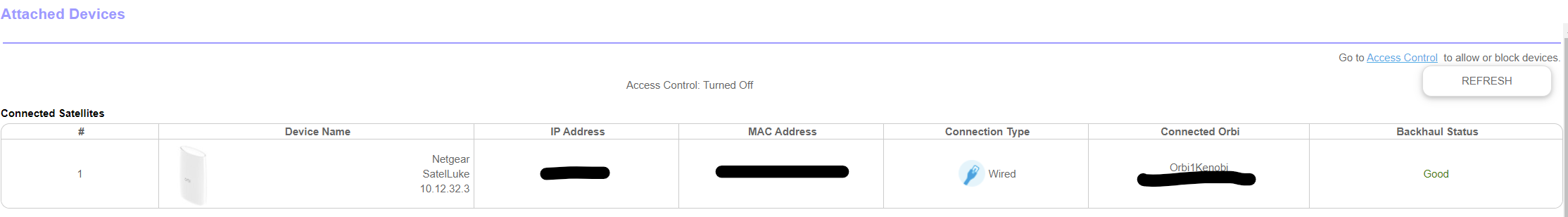

Web GUI shows wired backhaul to the satellite (attached) but all devices are shown to be connected to the RBR and the app doesn't connect.
