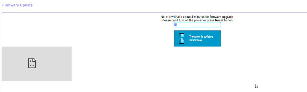

Anyway I will try to perform the loadinf of the new firmware during tomorrow , Problem I dont know how , because of the failing status in the Orbi router and the Satellite also .
Lets see . I don't have any optimistic feeling about if the procedure if going to solve this problems .
Question : If I have the Orbi Router in a turn Off Status , How Im going to perform the load of the new firmware in the Satelliter - Which is the default address to type in the browser to sign in? Do you have a post with a detail procedure in this cases ?
Factory reset to the devices , first loading firmware in the satellite (address?) and then in the router (address) with a wired PC and after that Load the Config file .
Let me know in order to perform the rights steps in the process . Thanks in advance .
- FURRYe38Feb 04, 2021Guru - Experienced User
You can manually load FW to the RBS if it's not connected to anything:
What you need to do is factory reset the RBS. Wire connect a PC to the 1st satellite. Already have the most current FW version files downloaded on to this PC.
Wire connect 1 PC to the back of the RBS. Factory reset the RBS, wait about 5 minutes. The PC will get a IP address from the satellite. The RBS will be 192.168.1.250. Use this IP address in a web browser to log in to the satellites web page. Log in as admin and password. Use the satellites web page FW update feature to select the FW update file that was unpacked from the .zip file. Then factory reset and then re-sync the satellites to the RBR.
if it's syned to the RBR then just log into the RBS web page and send the FW there directly using the RBS web page:
Use the RBS IP address to access it's web page.
Then do the RBR, I would already have the FW file downloaded, factory reset the RBR and manaully setup the RBR quicky. You don't need the RBR connected to the ISP modem/ONT.
Basic following same process as RBS, use the RBRs web page to send the FW file:
- AFDFeb 04, 2021Luminary
It seems satellite was updated normally .
But router Starts - a Whit blink light is blinking but the `router is in this status (no light) since 15 minutes
I dont know what to do .
Factory reset again as start again?
What browser are you using?
So you sent the RBRs FW file? Were you able to log into the RBRs web page after you sent the file?
Finally Router is in firmaware 2.5.1.6
According the status get in the orbilogin.net but Problem still remains . Dropping wifi connections every two minutes
Nothing change .
Regarding the Browser I used Chrome . (is there any limitation?)
Last alternative could be go for the last firmware available . But as I said no hopes .
Amazing failure and amazing support from your side . Is there any way to contact Netgear directly ? a lot of users said is a waste of time , but anyway I'd like to give them an opportinity before posting not to use Orbi in the future because of this type of failures reported and as far as I know nobody solve the problem .
Let me know all youtr thoughts . Remember 3 year without any single problem from the installation .
Thnaks in advance

32 - Downgrade the Orbi Satellite to version 2.5.1.16
33 - Downgrade the Orbii Router to version 2.5.1.16Soorty to distuurb you but just a simple question , after de upgrade (because I did it offline with no internet connection) which is the best way to conotinue
1 - Satellite and router are not synced
2 - Satellite has the address 192.168.1.250 and the Router 192.168.1.1
3 - Because my ISP has a 192.168.1.1 the previous upgrades change the Orbi Router to 10 .0.0.1
Wich is the best way to perform all the previous activities to perform the final conections and syn (I need the Orbi Router with 10.0.0.1 running) Let me know , please your thoughts about it to conitnue al the testing procedure
Thanks in advance
- FURRYe38Feb 08, 2021Guru - Experienced User
Does your ISP allow you to change the Modems IP address by chance? If they do you could change the ISP modems IP from 192.168.1.1 to say 192.168.2.1 or .0.1, then you can leave the RBR and RBS at 192.168.1.1.
If not, then setup the RBR by allowing it to change to 10.0.0.1 and use that to set up the RBR first. Once you have the RBR setup, I would then press the sync button on the RBS then on the RBR and let the RBS sync to the RBR. Do this with the RBS in the same room as the RBR.
- AFDFeb 08, 2021Luminary
Thanks a lot for supporting - Done !!
Satellite not synced yet - testing with router mode only -
5 minutes running with almost all the devices (exception devices that are too far and suppose need to be connected to the satellite) and the dropping connections started again . (1/2 per minute)
Let's see how to continue but I believe I've invested a lot of time (and money) trying to solve this issue .
netgear didn't pay attention to this issue , @netgear_help (on twitter) also - Nobody answer PM's , so it is time for definitions on my side .
Because of the Pandemy status , family is going to kill me before the Virus , so If nobody have any other ideas (very very welcome) , hardware will be replaced .
Im going to post the next steps .
