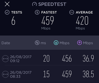

In trying to understand why my wifi speeds are so slow since v1.12.0.18... I performed the SPEED TEST option from the Orbi app which uses the OOKLA Speed Test service to test the speed between the router and the internet (no wifi involvled).
It seems strange to me that the router is consistently between 35% and 50% slower than the other wired connections on my network.
Here's my results from the Orbi app:
and here's the results from the OOKLA app on my iMac:
Both connecting to the same switch and to the same broadband connection.
Shouldn't the router be capable of the same speed as the other wired devices on my network?  How can we ever achieve wifi speeds that get near the possible bandwidth available if the router itself does not perform to its potential?
Has anyone else seen this with their own set up?
(I rund the router in AP mode if that helps)
Thanks in advance
Matt
PS - my wifi performance overall is now terrible since V1.12.0.18 with nothing else changing (no moving of satellites, etc).  I am currently getting <20Mbps (if lucky) where I was achieving 10x that - c. 200Mbps - previously.

      Hi.  Thanks for this reply, but I am referring here to the speed of the wired connection from the router to the internet and not the wifi connection from the router.

      Thanks. Things have definitely degraded since the latest firmware. I have speeds of around 450Mbps on my iMac and only 170-200Mbps from the router. It seems odd is all. My actual wifi connections seem slower too.   I'll try the reset.
