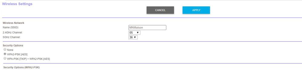

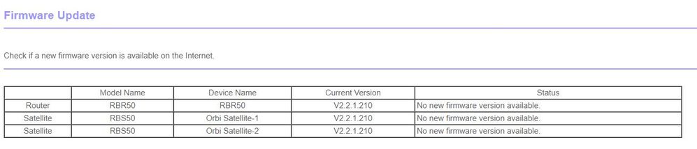

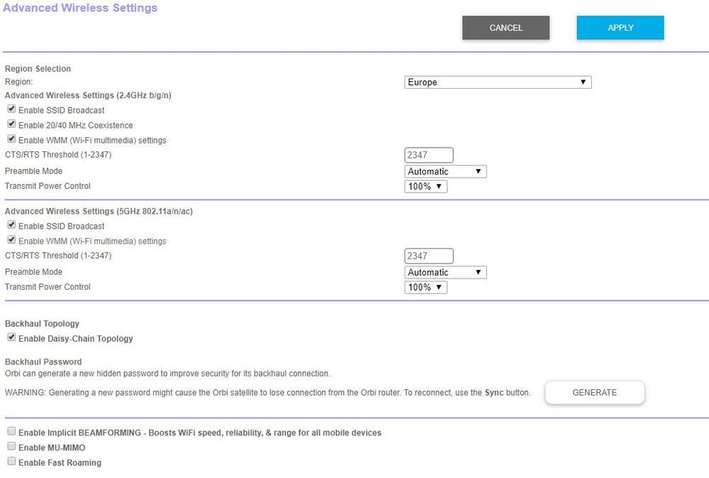

- MarcNettDec 31, 2018Tutor
I have add picture with the configuration.
But it seems disabling BEAMFORMING and disabling Fast rooming improve the situation, This morning the 2 phones are still connected to the WIFI without error.
I continue to monitor
