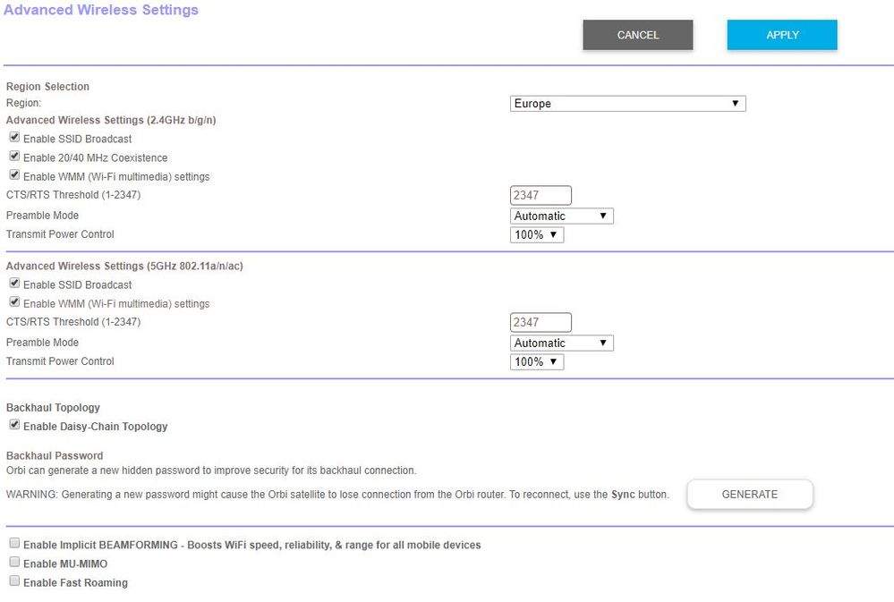

Advanced Wireless Settings both 2.4GHz and 5GHz changed CTS/RTS Threshold to 2307.
Change the CTR/RTS threshold values for both 2.4 GHz and 5 GHz (2341 and 2345 respectively), changed preamble modes to long preamble, and Set 20/40Mhz Coexistence to 40Mhz only.

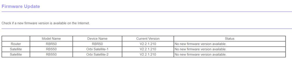

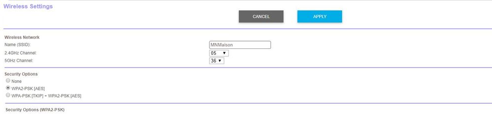

- MarcNettDec 31, 2018Tutor
I have add picture with the configuration.
But it seems disabling BEAMFORMING and disabling Fast rooming improve the situation, This morning the 2 phones are still connected to the WIFI without error.
I continue to monitor
- FURRYe38Dec 31, 2018Guru - Experienced User
Thanks for letting us about those settings.
Something someone may want to contact Samsung about and let them know so they can also review this situation with there phones running on Orbi.
