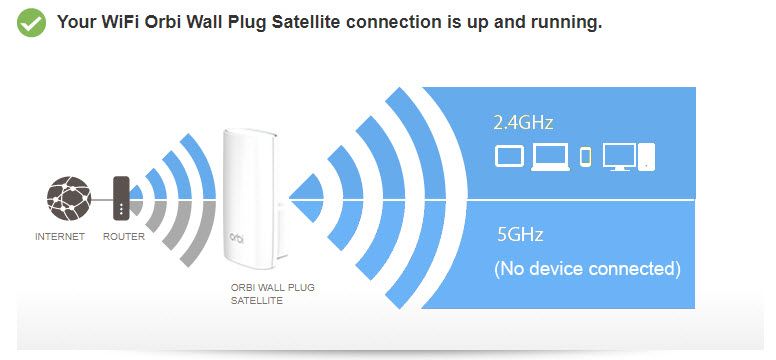

I recently bought the RBW30 (firmware V2.0.0.34_1.0.21) wall satellite to add to my ORBI network. It has connected to the router (RBK50, firmware V2.0.0.74) but at 2.4Ghz not 5GHz. see following pic;
I have rest the satellite, resynch but had no luck. How do I get it to connect to the router at 5GHz? The Satellite is located 5 metres from the router with no obstructions.

  • Problem solved. Factory reset corrected problem and updated region from Europe to Australia correctly.

  • why is it so close ? thank it further away and see if it will connect to 5 gig
    sorry cant see pic

      Thanks for the reply. I've tried to upload the JPG again.
      The reason it is so close is because the NAIM NDS5 media server has a very poor connection to the router (the reason I bought the satellite). It now has an excellect connection with the satellite next to it. Moving the satellite further away will mean the media server will lose it's connection again.
      Moved it 10 metres away and same result. Why would distance affect which frequency it uses?

        because wireless ac 5 gig is very sensitive to overload and interference
        the image is still not showing but when you access the 30's gui what does it show on the backhaul
