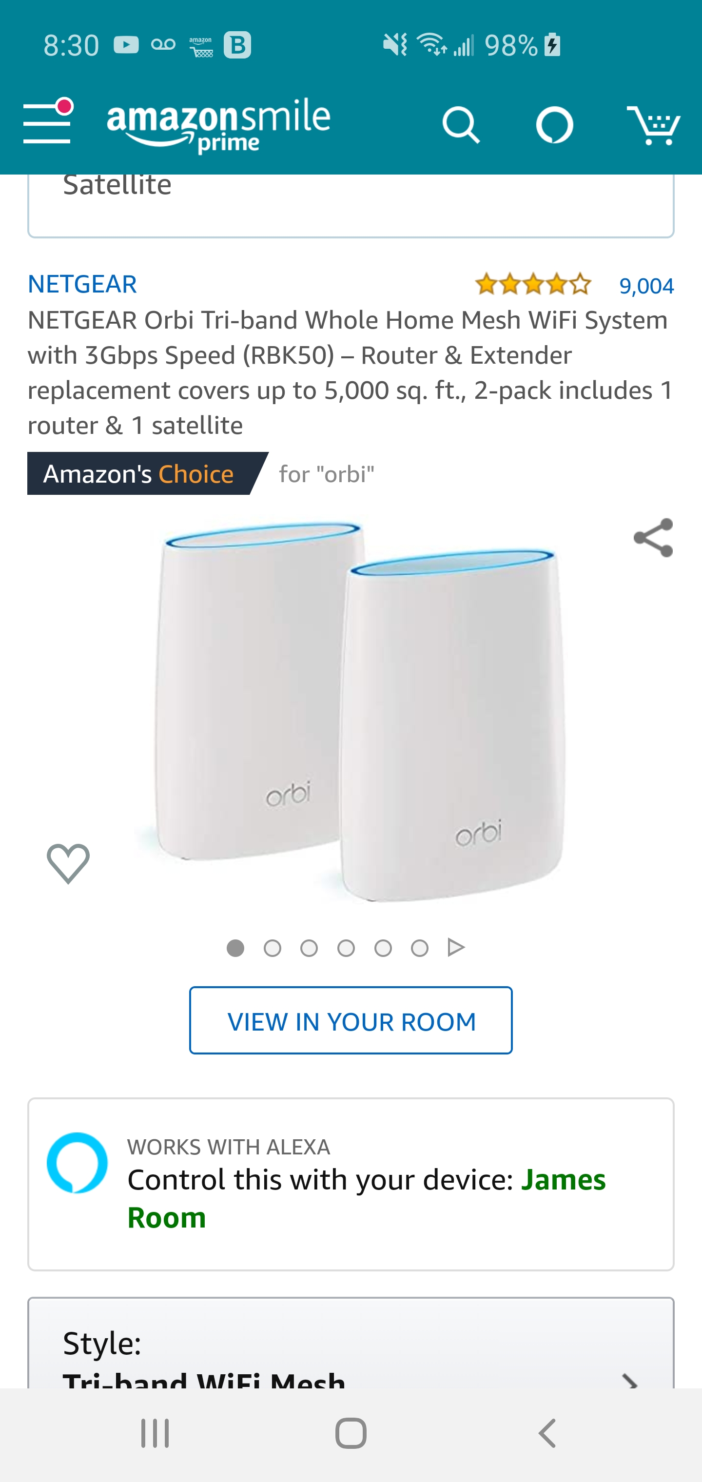

So I'm confused as to which model I have so that's why I posted the image of the one I have and I got an additional satellite for this system. But for some reason on my xbox one x. Streaming gives poor quality and I keep being disconnected from Call of Duty modern warfare 2019 servers. What should I do? I have beamforming on, UPnP is on, Ipv6 is on, mu mimo is on, daisy chain is on, and 20/40 mhz coexistence is on. Why is this happening? It's on firmware version is 2.5.0.38. Please help

So I'm confused as to which model I have so that's why I posted the image of the one I have and I got an additional satellite for this system. But for some reason on my xbox one x. Streaming gives poor quality and I keep being disconnected from Call of Duty modern warfare 2019 servers. What should I do? I have beamforming on, UPnP is on, Ipv6 is on, mu mimo is on, daisy chain is on, and 20/40 mhz coexistence is on. Why is this happening? It's on firmware version is 2.5.0.38. Please help- James_WheelzAspirantCGM4140COM first 0 is a zero and second 0 is a Oh. It's the Cox Panoramic Gateway. My house is about 6000 square feet. The satellites are about 30 feet apart. And my xbox is about 20 feet away from the satellite. So hardwiring isn't possible for me.
