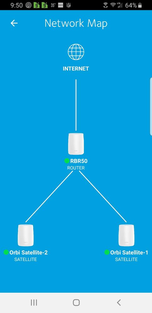

Trying to add a satellite to my RBR 50 mesh system.
So, currently have a RBR mesh system with TWO RBS satellites.  I am attempting to add an additional RBS 50 and for some reason having massive trouble.  I ran a CAT cable from one of the existing satellites to the "new" satellite I am trying to add.  For some reason it wasn't working.  Any advice/input is appreciated.  Thank you!

    Update, so I was able to successfully configure it. First, I hard reset the "new" satellite.  Next, I added  it to my existing network(wireless).  I then plugged a CAT5 cable from one of my existing satellites to the "new" one.  All good now! Thank you!

     Perhaps one way to approach this question is "one step at a tiime."  i.e.
    • power up the new satellite in the same room as the router and go through the "Add a Satellite" process using WiFi. This validates that the satellite works correctly.
    • Once the satellite adds successfully, connect it to the router using an ethernet patch cable.  Within a few minutes, the satellite should recognize the ethernet connection and switch from WiFi backhaul to ethernet backhaul. This validates that the satellite can use the ethernet backhaul.
    • Move the satellite to the desired location and connect to the Cat? cable.  If it does not connect, the cable is suspect.

    Is Daisy Chain enabled on the RBR?
    Any LAN switches in the configuration?
