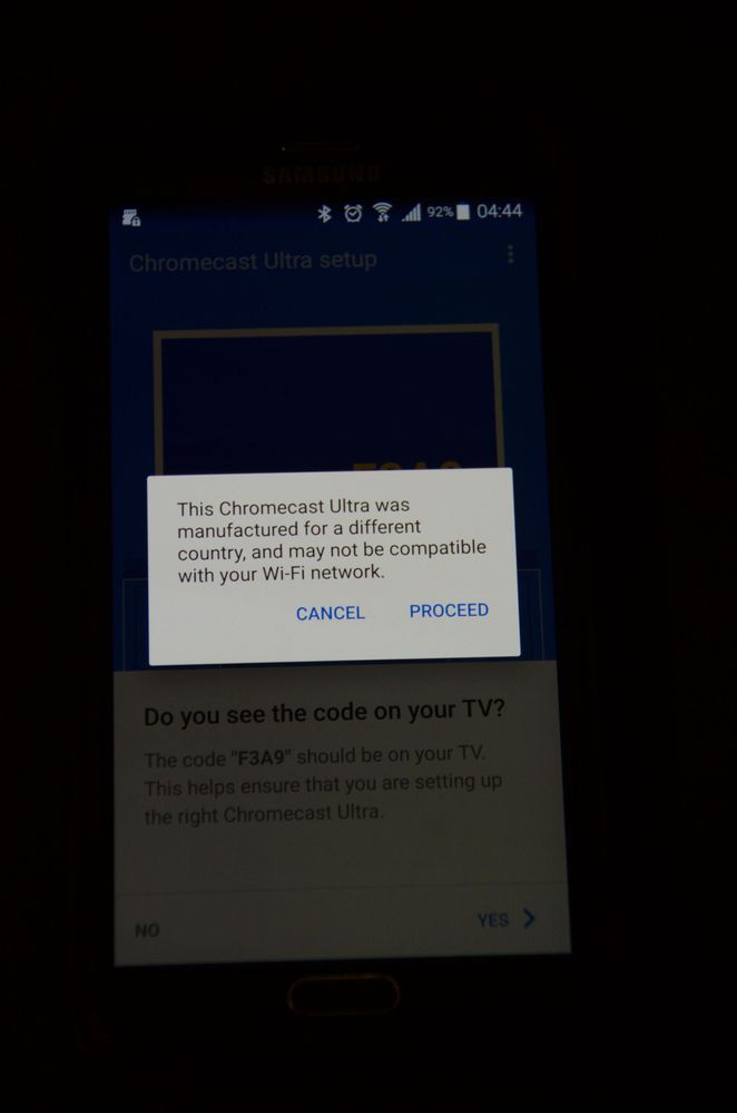

Unable to setup Chromecast Ultra over Wifi - claims it was made for a different country !!
I just bought a Chromecast Ultra at Best Buy in California and tried to set it up on my Orbi AP, bought in California also.
This is the error I get . I had to use my DSLR to shoot a picture of the phone as it wouldn't allow taking a screenshot - that made the dialog go away.Even after I click proceed and tell the Chromecast to use the Wifi password from my Wifi, the Chromecast Ultra setup fails.
I tried 3 times with the same result each time. It's a no go with Orbi.

  • A
    I tried it over Ethernet and it updated its firmware and worked fine.
    Unplugged Ethernet, and still faced the same issue. Couldn't set Wifi.
    Then, I turned off "Implicit Beamforming" in Orbi.
    I was then able to proceed with the Chromecast Ultra setup. But I still experienced the strange dialog above !
    Is my Orbi really using foreign Wifi frequences ? Can I expect the FCC to come knocking at my door ?
    Once the Chromecast Ultra was setup, I re-enabled beamforming. The Chromecast ultra still worked on Wifi.
    Go figure !
      Take a look at "Advanced settings --> Wireless Setup".   There is a Region Selection at the top of the page.  You should double check that is set right.
