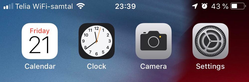

  • I have Orbi and VoWifi is working just perfect. Here's a snapshot from my iPhone:
    Please note that -usually- Whether 4G (VoLTE) or Wifi (VoWifi) is prefered is an operator setting and it's not your phone which decides.
    So -usually- the phone will always select VoLTE as long as 4G coverage is good, and will only select VoWifi if 4G coverage is not that good. So probably you have a good 4G coverage at home and that's why the phone will lways choose not to go for VoWifi.
    A good way to test if VoWifi is working is to set the phone in Flight Mode and keep wifi activated so the phone will then be forced to use VoWifi. Have you tried that?

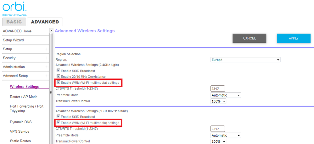

        Please also check that you have WMM activated in Orbi as follows:
