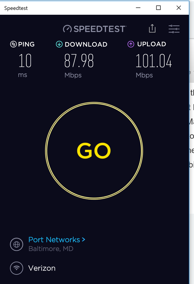

After switching back to the 100/100 mbps these are the numbers I'm getting and it varies from time to time bc sometimes I can get it to clock in at over 100mbps up/down and that's wifi and not tethered to anything. Granted I have 7 devices connected to it but still I get similar numbers when I try the test on my iPHone 8+ and that's one of the newest phones out right now so I know it can handle a fast connection to the internet. I'm not so sure about the Surface Pro 2017 even though it's 1 month old. I have the i7/8GB/256GB Memory version for $1,299 and I had to get it for work. I use the tablet/pc on a daily basis for my work as a Loan Processor and I'm allowed to work at home and that's why I wanted to upgrade but it doesn't look like I'll be getting my money's worth.
