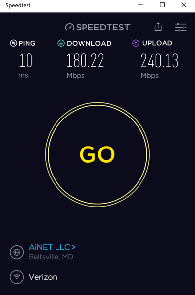

I have the RBR40, the one with a base router connected to the FIOS router and a plug in satellite. I have the main router connected to the FIOS router as this was the only way the verizon tech told me I could use another router besides theirs but their router sucks. On a 100/100 plan I can only get about 40-50mbps on wifi and with the Orbi Mesh Router, I get anywhere from 80+ wifi. I never use ethernet eventhough I know it's supposed to be faster and that's the best way of getting the best speeds but the problem is that I don't have a ethernet cable log enough to reach my basement where most of my work is done. The Tech put the router there as it is the centerpoint of the house. I know there is a way to turn off the Verizon FIOS wifi but I don't remember how to do it and I'm sure it's conflicting with my Orbi router and like I said, anyone who can help me replace the FIOS router with my Orbi router then I will pay you $50 via paypal for your time. You also have to help me maximize the setting on my Orbi to get me the best connection. If you can do that then I have no problem paying you for your time. With that said, the more devices I have connected to the router will decrease the speed too right? I'm contemplating whether or not to connect everyone's devices to the Orbi router bc I don't want to bog it down even more. Right now I have about 7 devices and if I got rid of the Verizon router I would need to add an additional 5 devices. that would be about 12+ devices. 5 of which is using the satellite and 2 using the Orbi base system then my mom and dad's iphone and ipad are using the FIOS router. The FIOS router is really crap and I can't stand it but the tech at Verizon FIOS won't help me remove the router altogether and told me the only way I could get the Orbi to work is if I tethered it to the FIOS router. Is this true? Does anyone know if this is true or not? Also, will the more devices you have bog down the network speed or will it not affect it at all? Please let me know. Thanks in advance!
Attached is my most current speedtest using Microsoft Edge on a 2017 Surface Pro i7/8GB/256GB Memory configuration.
