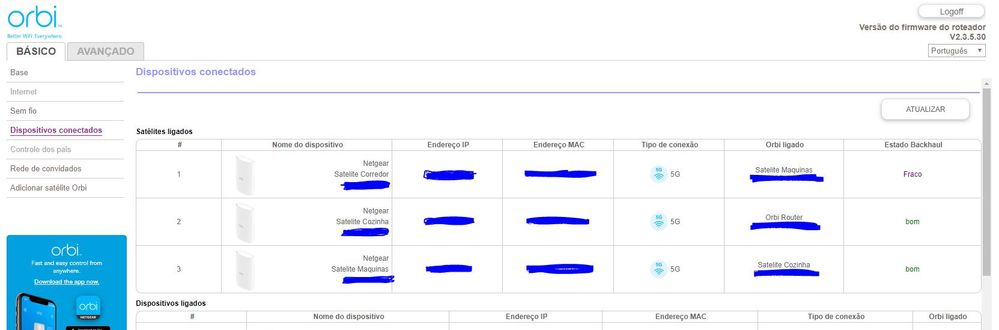

I see no such disconnect button on my GUI...
I will try to proceed with the reset without pushing that button though.
As you can see the first satellite in the list has a "fraco" (weak in portuguese) status while being no more than 7 meters away from the next satellite in a straight line, with a thin wall in between them. It used to have a strong signal since the start up until a few weeks ago...
Nevermind. After resetting, the button did appear...
