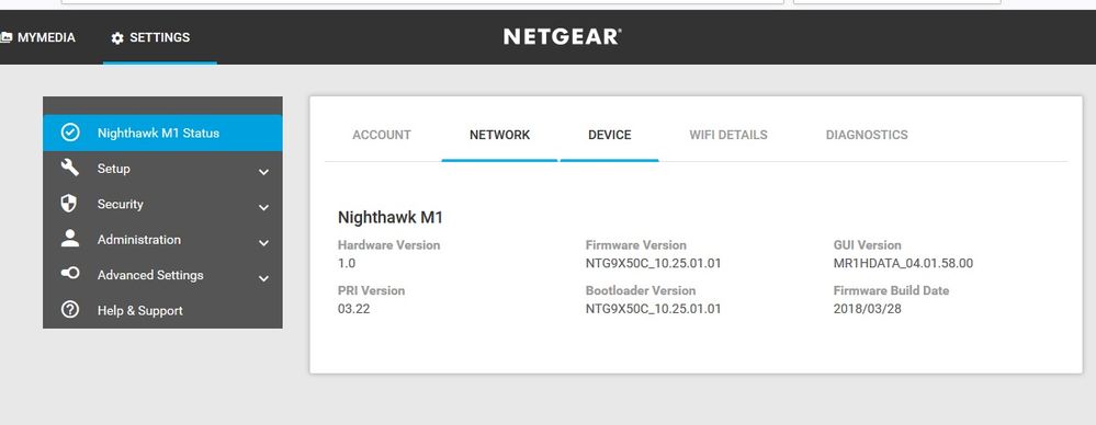

      The new firmware jsut released is version NTG9X50C_10.25.01.01, note the extra .01  so I'm guessing it is a minor bug fix. Pri version is 3.22
      • MicW's avatar
        MicW
        Luminary
        No noticeable changes. Everything so far seems to work on a non telstra sim. RS-SINR still displaying 0 dbm, but that is a minor thing. I'm assuming this is the fix for the telstra display, I guess hippolyte will let us know soon if it is working if he upgrades his first M1. And hopefully everyone affected by the bug that prevented firmware updates is fixed now too.
