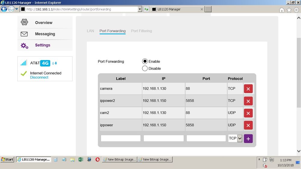

Can't open port in LB1120
I am unable to open any forwarding ports in my LB1120 LTE modem. If anyone has done this successfully, please tell me ALL the settings. I am using an Acer laptop running Windows 7 and an 8-port switch. I have attached screenshots of my current settings. The servers I am trying to reach both have fixed IP addresses on my LAN.

  • I just got this modem yesterday and I am setup and working, all except for 1 thing, Port Forwarding.
    I have setup several ports for forwarding. Some to access the live stream for my camera and some for http and ssh. Only none of them are working. I cannot access my network from the internet. Inside my network everything works fine. I can view the streaming video or ssh to another server. But from outside I cannot even connect. Any help would be greatly appreciated. Thank you.

      This is an old known problem and it's caused by your 4G LTE carrier.  The IP assigned to you is NOT visibile on the internet so you will not be able to port forward. Apparently is was visible on 3G networks,  but not for 4G and problable not for 5G either.
      I have 2 installations,  one on COMCAST cable and no issues.  The other is ATT 4G LTE/LB1120 and I have been unable to access the ports from the internet.
      The solution is to request a FIXED IP: from your carrier,  but this will cost $500. An alternative is use TEAMVIEWER remote desktop,  but you will need to install a server at the  remote location.  I can't say performance is that great.  Mine seems to work only for 30s at full speed and then intermittently after that.
