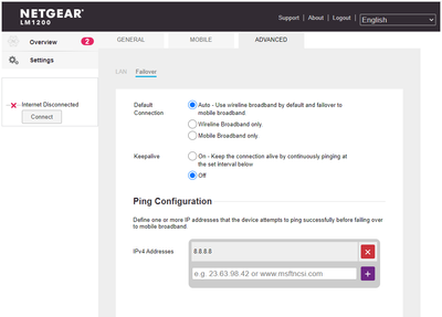

      Is the keepalive timer a setting on the router or the LM1200 LTE modem? I am not familiar with what you are talking about so I appreciate an explanation if you can. Thanks!

        Sorry. The setting is on LM1200.
        Please log in to WebUI by visiting 192.168.5.1. The admin log password can be found on the product label.
        Then go to Settings -> Advanced -> Failover -> Select radio button On for Keepalive.
