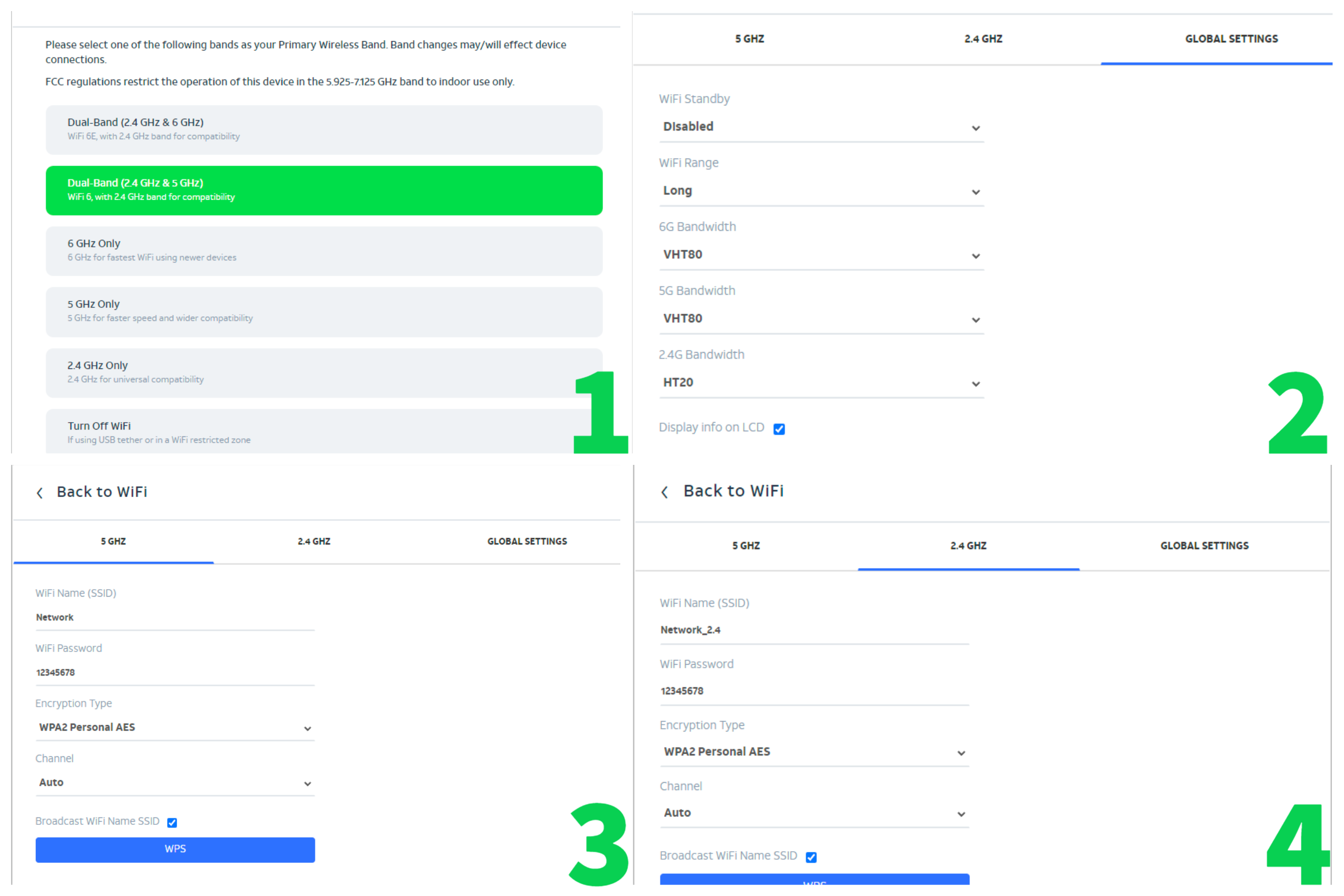

I recently purchased a 5G WiFi 6E Mobile Router (MR6500) with a Firstnet plan from AT&T and have a problem I haven't been able to solve. The 2.4, 5 and 6GHz modes work fine by themselves. The problem is when I turn on "Dual-Band (2.4 GHz & 5 GHz) Wifi 6" or "Dual-Band (2.4 GHz & 6 GHz) Wifi 6E" the only SSID that shows up on my devices is the one for the 2.4GHz network. I made sure both networks are broadcasting in the settings and had different names. I tested to see if it was a Wifi version issue by using a Pixel 7 Pro that has Wifi 6 and 6E support but, even then, I could only see the 2.4GHz network. I also noticed my guest network does not show up at all. I have tried to reset the hotspot to factory defaults a few times to no avail. I contacted Netgear support to get help with this issue but was told it wasn't their problem since it was purchased at AT&T. I figured I would check here to see if this is a known issue that can be solved or if I should just claim warranty with AT&T and try another unit. I would rather not have to do this as the unit I have took almost 2 weeks to arrive.

          I've attached a picture containing the menus I am seeing while setting up dual band mode (Using example SSIDs). Hopefully it will be helpful. I am definitely able to create two different SSIDs associated to each band while in dual band Wifi 6 mode and have each one set to broadcast its SSID in the menus (as seen in part 3 and 4 of my picture). My problem is that the 5GHz band which should show up as the SSID "Network" on my device, does not. Not even in the wifi analyzer app. I am only able to see the SSID "Network_2.4" in the wifi analyzers' 2.4GHz network tab which is correct. The 5GHz tab shows no network bands or SSIDs being detected at all like the router is not broadcasting as it says it is. Which is weird because 5GHz mode by itself works and broadcasts as it should. I believe the unit may have a hardware problem at this point as I have used other routers that have had no problem broadcasting 2 different SSIDs for the two bands selected. As for setting both SSIDs to be the same. I am aware that I can set them both to be on the same SSID but I need them to be two seperate ones for my application. Hope this clarifies things a little more. I appreciate your help so far.
