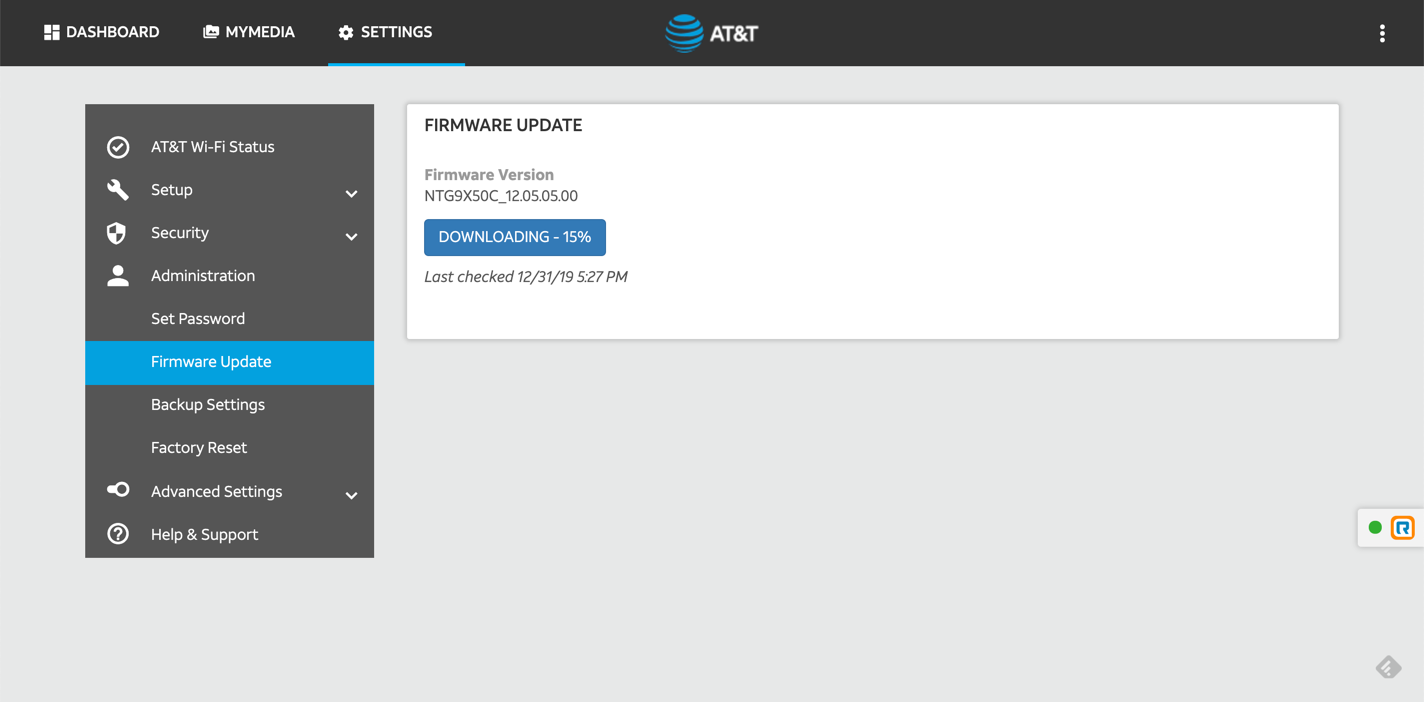

      I just randomly clicked Check For Firmware Update as I usually do and to my surprise, there's an update being downloaded.
      The question remains: What does this long-awaited update actually bring? The 'release notes' on specify two fixes, but I can't believe that this update which took so long to arrive only has two fixes.
      Bug Fixes:
      • Resolved the issue where the device may reboot when using the device without a battery
      • Resolved the issue where the Ethernet standby timer setting is not displayed.
      Is that all that this update includes???
      Screenshot of integrated firmware update attached.
