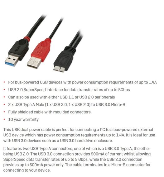

  • Update:
    A bit of Googling suggests that an External SSD may in fact need additional peak power to the 2.5" drive.
    A USB 3.0 Dual Power Cable, 2 x Type A to Micro-B might be the answer to supplement some additional power, will pick one up tomorrow.
    • Downunder55's avatar
      Downunder55
      Unfortunately that supplementary power cable didn't work, still allows access to the drive and media, but as soon as you start playing media it reboots.
