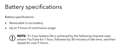

        Please note according to our internal testing as per our manual , page 60 , I would like to compare with your scenario with this , that´s reason of above questions

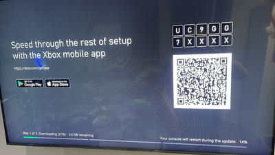

        # For the Xbox, Im testing here with my Xbox one, selecting Performance power mode and Xbox is working fine, Im downloading the lasts update, can you verify that selecting performance mode works for you ? in Balanced   mode the Giga port is off in the M6 by design . Again , our recommendation for gaming scenarios using Ethernet port is maybe use the M6 as a fixed router , removing the battery  and power it with the provided power adapter, as explained in previous post.
