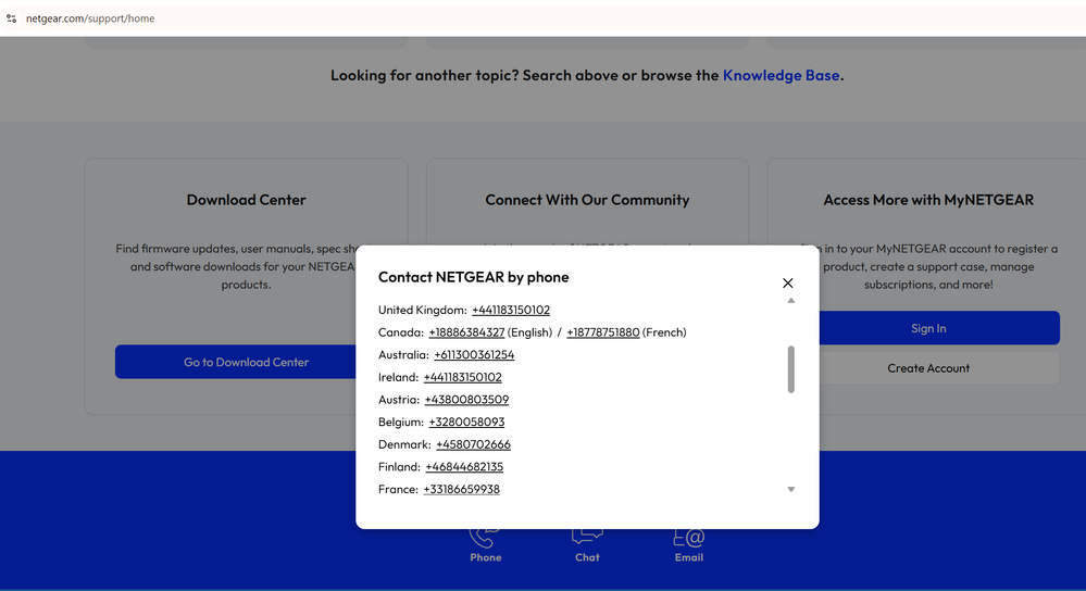

This issue has been going on for well over a month and Netgear Support have been unable to resolve the problem for me? They have even stopped responding to my messages. I have spent hours on the support centre with them and they keep asking mr to send them a .json file which I have done several times.
Can someone please let me know what my next step should be. I am based in the UK. Is there a UK telephone number for Netgear Support that I can use. Has anyone experienced similar issues with the Netgear Nighthawk MR7450.
