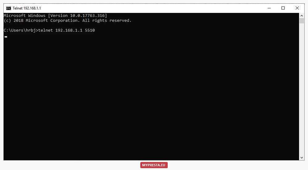

  • Ok, i found that it does not matter if port is filtered or not.
    It is enough to connect with USB, then just use telnet 192.168.1.1 5510
    you will see just black screen without any kind of information, like i show below:
    It is confusing, no message that you connected etc. ;)
    So, once you will see this weirdy-looking black screen without any responsse - it is just enough to start type the AT commands.
