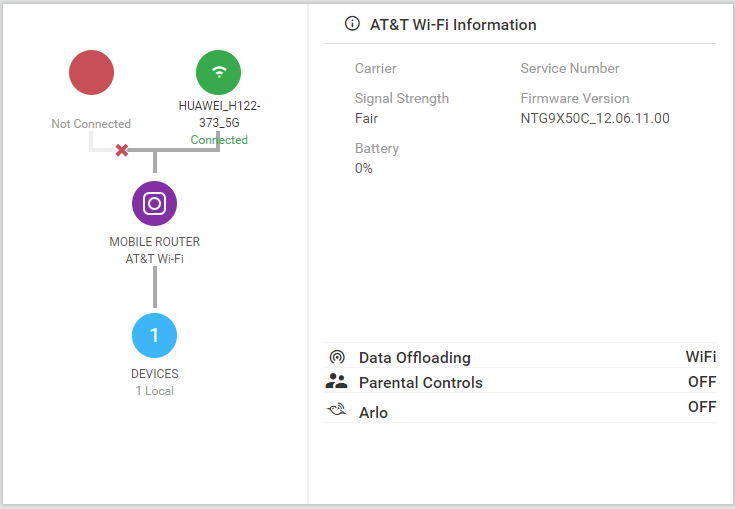

  • Have exactly problem on my new M1.
    Offloading works fine using ethernet, but when I try WiFi dashboard says Not Connected. I've tried 2.4, 5 and dual and get same results.
  • tried with battery installed data offload over WiFi, it does work (firmware 12.06.x), even reboot M1 without battery, the setting still remained and works
