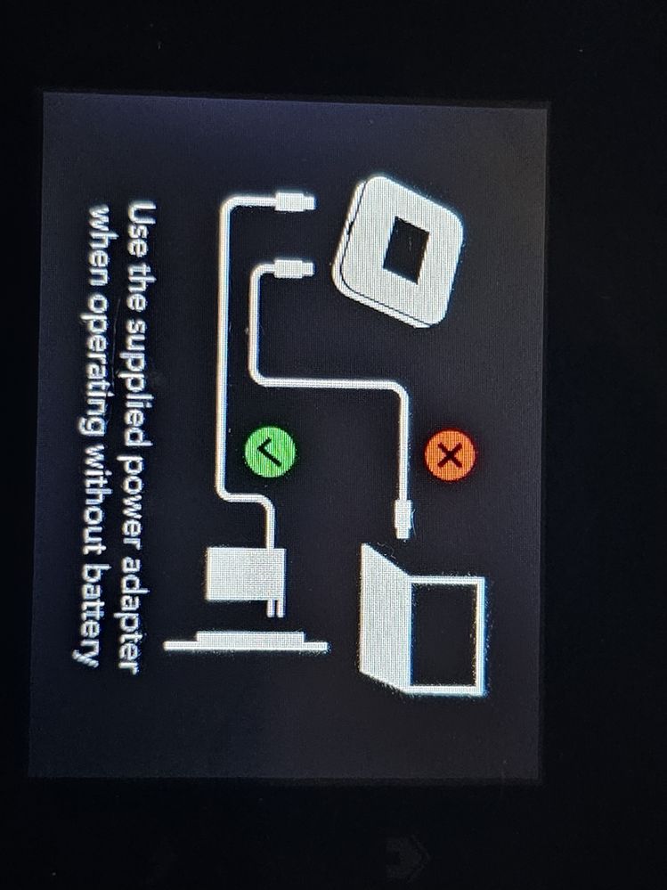

Nighthawk M6 mr6110-1s4mes (Use the supplied power adapter when operating without battery)

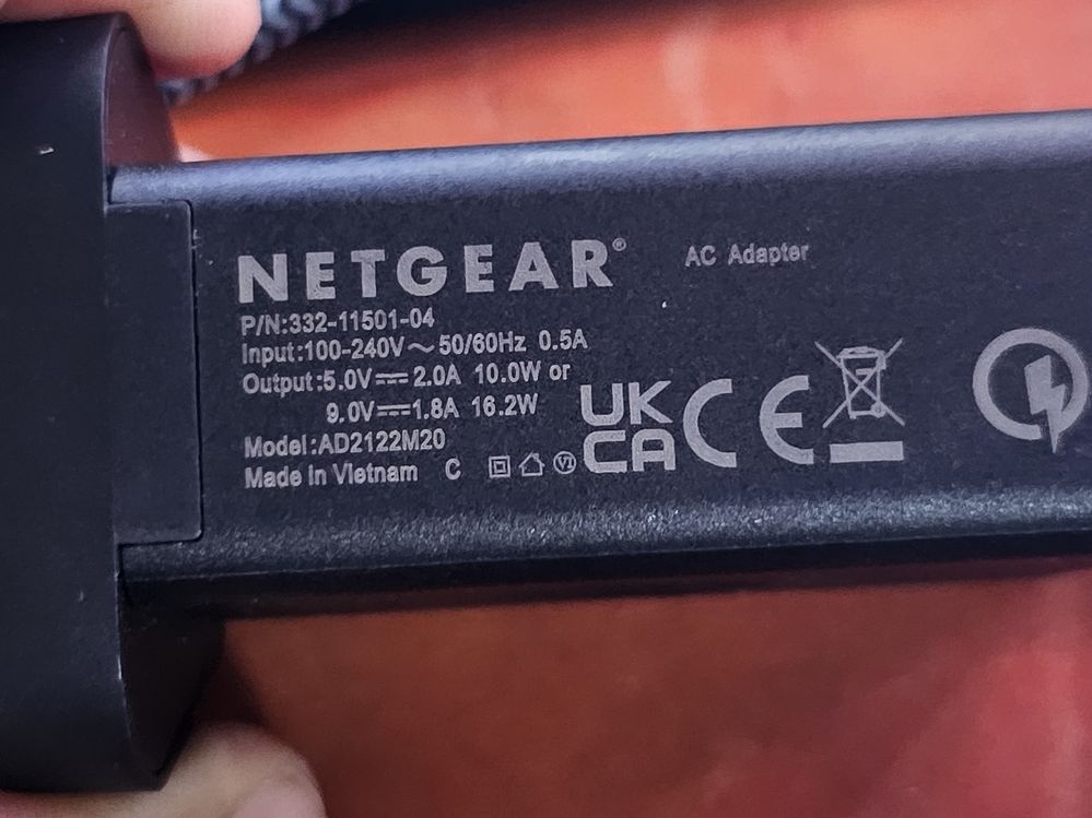

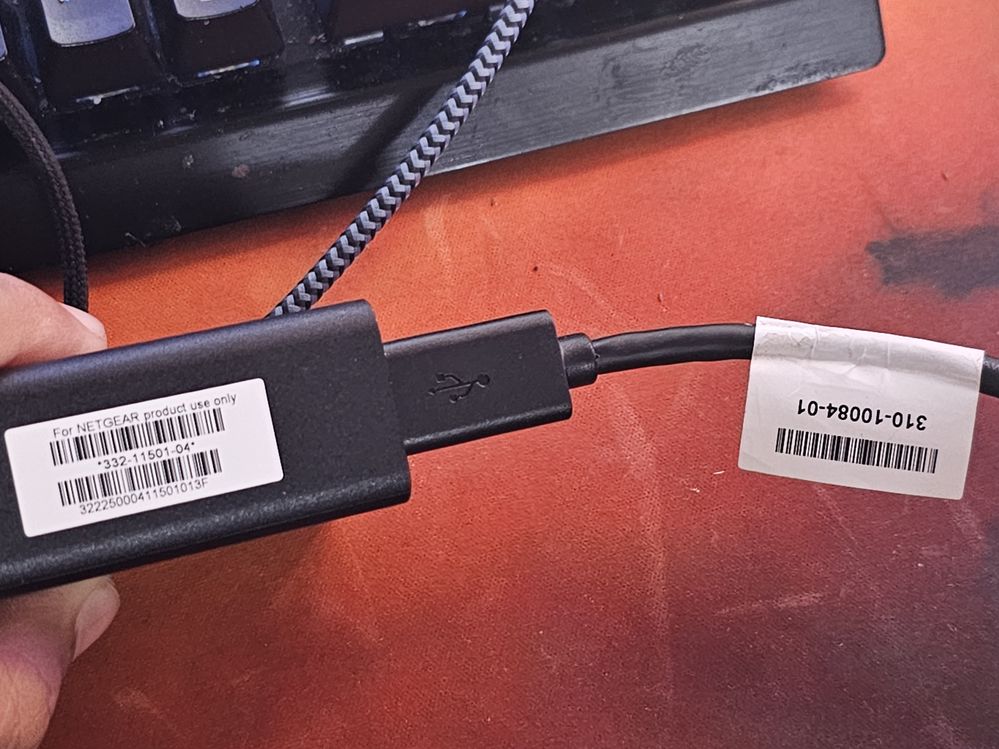

My problem is when I try to operate the device only via the cable without using the battery, I receive a message in the device stating (Use the supplied power adapter when operating without battery) even though I use the cable and power adapter that came with the device
  • Hello, the problem has been solved by doing a factory reset of the device. The problem also occurred to me after an update to fix some problems, as it helped me to provide the device with the new update ( JohnPeng ) because I was having a problem with the 5g connection of STC Saudi Arabia. As for the version of the device, it is from By STC Kuwait

    No reason for the communication between the USB-C (?) power supply and the main mobile router not working. Could also be a flaw on the power supply provided however..
    Based on the designation MR6110-1S4MES this looks like yet another a carrier (?) or vendor specific model, unlocked (?), and leaked to the free market e.g. via AliExpress, among others.
    JohnPeng please. Are we facing another cumbersome variant with limited band availability here, or is this an official unlocked version?

      Can you provide details of your firmware on MR6110-1S4MES ?
      it should work in Non Battery operation with the supplied Power supply

        "Should" makes a lot of sense. Hope you don't refer to the AC-only config in the menu? Are these general available models, or are we facing some Kuwait stc carrier (locked) devices?
