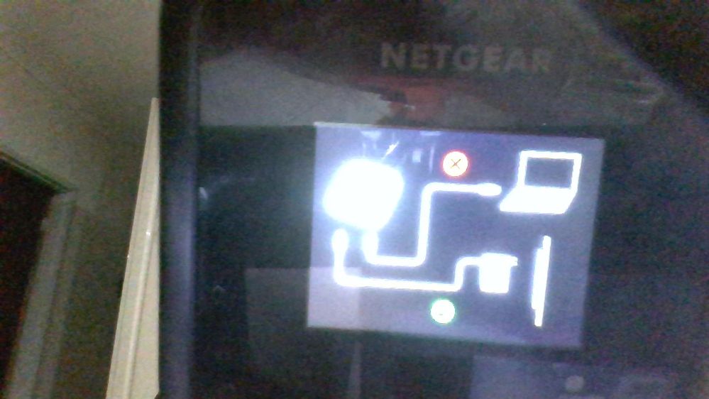

I've removed the battery after powering off. When I connect the USB cable the Nighthawk will not start. It shows a screen like it is looking for an Ethernet cable. I've done a factory reset and gone with default settings.
Screen on the Nighthawk MR6110

- MillsieAspirantYes I have the same challenge. The diagram shows that it must be plugged into the supplied AC power pack. The mystery is that the AC power pack has a usb output so logically plugging into a normal usb should be ok. So the 6110 must be able to detect that it’s connected to AC?

Are you getting the image when you connect the USB cable to the PA provided with the device?
The image will show if you connect the USB cable to your laptop's USB port. Such connection is not supported since laptop USB port may not provide the enough power to operate the device.
