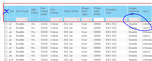

Check the System > PoE > Advanced > PoE Port Configuration page
For simplicity, I suggest to change the negotiation time for all ports.
Post a screenshot of the complete table, and we figure out together in case.
- hunte88Jun 20, 2023Aspirant
Hi, in the page of POE configuration i see on the left, what must i do for setting it ?
You speak of negotiation with ipcameera but is on other menù, (see on the right) and i already setted on full for negotiation but the problem persist.
Thanks a lot for the help- schumakuJun 20, 2023Guru - Experienced User
Select all ports by using the [x] to the left, then change (all) to Longer Detection Time [enabled], then [Apply] or [Ok].
I have done it now but not work the ipcamera.
