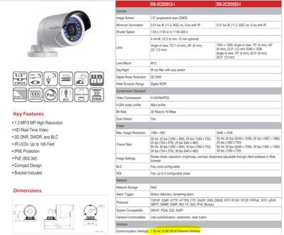

According to the Hikvision DS-2CD2032F-I information (including the datasheet) it's clear these discontinued value cameras have a 1 RJ-45 10 M/100 M Ethernet interface only. Difficult for the switch to negotiate a higher link rate.
Disappointment where disappointment belongs to please. Look, Netgear has even added an off-standard PoE negotiation timer to make these basic cameras workable. 8-)
But seriously: A Fast Ethernet link is perfectly fine for these value cameras - there is not more coming out there:
Max. Image Resolution 1280 × 960 2048 × 1536
Frame Rate
50 Hz: 25 fps (1280 × 960), 25 fps (1280 x 720),
25 fps (704 x 576), 25 fps (640 x 480)
60 Hz: 30 fps (1280 × 960), 30 fps (1280 x 720),
30 fps (704 x 576), 30 fps (640 x 480)
50 Hz: 20 fps (2048 x 1536), 25 fps (1920 × 1080),
25 fps (1280 x 720)
60 Hz: 20 fps (2048 x 1536), 30 fps (1920 × 1080),
30 fps (1280 x 720)
The same applies to the replacement product promoted down the line like this DS-2CD2645FWD-IZS 4 MP Outdoor IR Varifocal Network Bullet Camera btw.

hunte88 still expect to get an impossible Gigabit link speed or what?
Have challenged Hikvision about their camera model? According to the details you posted, the camera does negotiate and establish a Fast Ethernet link. Keep in mind, this series and specs were outdated for several generations since that product release.
Netgear has introduced an off-standard control to allow these camera series succeed on the PoE handshake. For the fun of it I've just released this updated firmware https://kb.netgear.com/000065628/MS108EUP-Firmware-Version-1-0-1-9 :
Enhancements:
Support for a new PoE option of "Longer Detection Time" for some powered devices (PDs) that require longer detection time such as Hikvision camera model DS-2CD2146G2-ISUI or model DS-2CD2046G2-IU.
Both these models clearly show Ethernet Interface 1 RJ45 10 M/100 M self-adaptive Ethernet port, so no way for a Gigabit Ethernet link.
That much about Netgear does not "support" this camera brand. For further troubleshooting, challenge Hikvision as the camera vendor....
