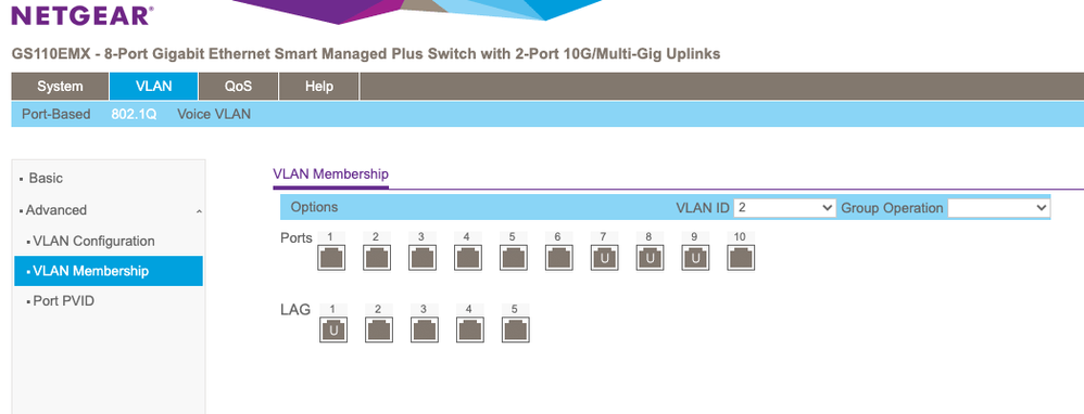

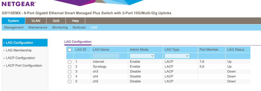

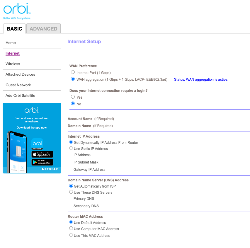

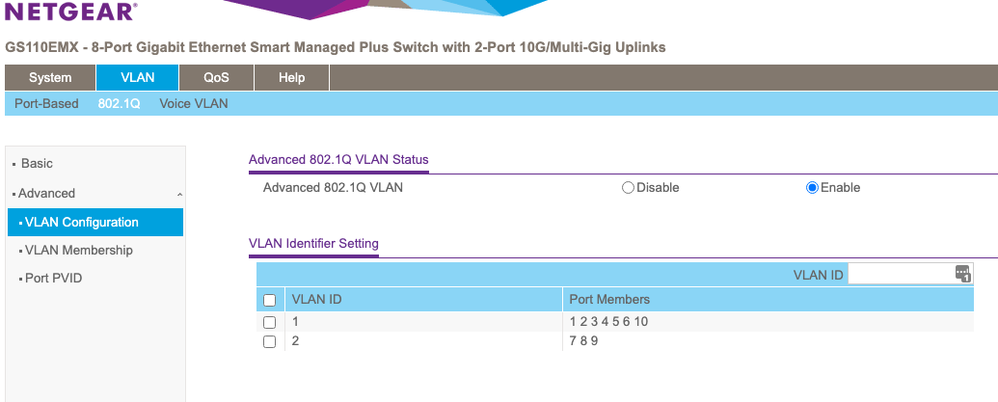

      Thank you!  You nailed it!  I had actually preconfigured those setting on the switch as my next test (When wife wasn't using internet) and having you confirm it really helped.  Maybe someone else can use this obscure configuration to get 2gbs throughput with Orbi AX4200 and newer multigig modems.  Thanks again.
      Info for others wanting to try something similiar here is my configuration and my results.
      Ports 7&8 are the LACP 1gb connections. - In VLAN 2 (WAN side of ORBI)
      Port 9 is the Multigig coming from the Modem at 2.5gb - In VLAN 2
      All the other ports are in VLAN1 which is where the return LAN from the ORBI which is 1gb.  In the future I may get a 2.5gb USB-c adapter to test on a locally wired PC to see if I get break the 1gb barrier.
