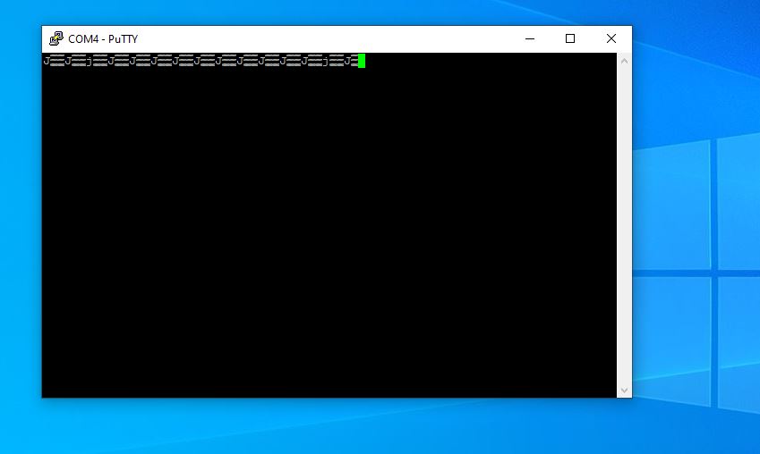

After plug in the Power Cable, i saw that in the Putty Windows:
jpg as attachment

Thanks for the screenshot, unfortunately you didn't tell us the configure baud rate, this looks quite a bit like the typical garbage given by a misconfigured baud rate. Please try the afforementioned baud rates in PuTTY (which does default to 9600 if not told otherwise).
If you are using a USB Type A to Mini-B the chance of a pinout problem is technically nil. The only possible issues left are the baud rate and the physical switch that I've mentioned previously (or a completely toast switch, let's hope not). If you use a DB-9 cable in combination you need the right pinout. Also "el-cheapo" USB to DB-9 converters can cause all sort of weird behavior. (This is a reason why I've spent the money for a "proper" genuine FTDI-based USB to DB-9 adapter cable for devices with a serial console port.)
