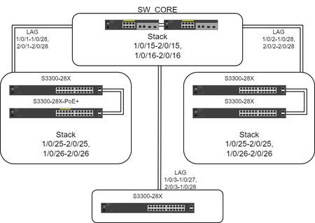

M4300-8X8F (stacked) with LAG to S3300-28X and VLAN - configuration issues
 Hi all,     this is my network:         the sw_core are two stacked M4300-8X8F, switches 1 and 2 are also stacked, switch 3 is a single device.     There are also some VLAN configured:  VLAN 1 (defau...

Have you already tried setting the LAGs for VLAN1 to Untagged instead?

- MettwurschtDec 05, 2022Aspirant
Hello,
yes, I tried this. Changing VLAN1 from tagged to untagged works for a while. But not very reliable. I've experienced e.g. paket loss and suddenly networks stops working again.
Next I'll change the LAG setup to a single connection.
- MettwurschtDec 06, 2022Aspirant
Today, I changed the LAG setup to a non-LAG setup and enabled just one of the two ports. Additionally I set every VLAN to tagged. Up to now there are no further problems on the network. Next I'll enable one LAG to see, what is going to happen.
- MettwurschtMar 09, 2023Aspirant
After enabling LAG, the error occurs again. What am I doing wrong?
