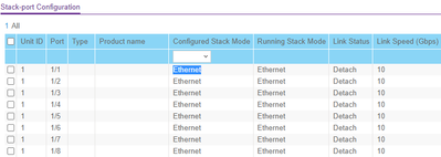

And all ports are in physical status Unknown and Link Status Detach:
The same module on other switch of the same model version and firmware, I don't have this issue like we can see below on slot 1:
In the stack-port configuration every port is in Ethernet mode:
I can never make any port in link status UP with this module on that specific switch...

  • I found where was the problem.
    The status of the slot was mismatch in Management -> Slot Configuration
    There was a different model connected before.
    Just delated the old one and I chose the correct one fixed the problem.
