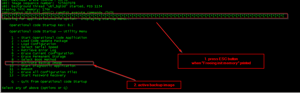

    Here is my suggestion to you for device recovery and troubleshooting(following screenshoot will help you on this)
    1. Connect the Console port to M4300 and keep press "ESC" button when you see the key word "Freeing init memory"
    2. Select “Active the backup image“ for workaround and then M4300 should bootup with backup image normally.
    3. If system bootup successfully, export configuration file to local backup.
       a) And also please export techsupport file and share to us for debugging.
       b) If possible, please also send the full console log when this issue happened and M4300 can not bootup.

      Hi DanielZhang
      Thank you very much for your detailed answer and your help. I already went through the "recovery" by activating the backup image which worked, the switch is up and running again with the older firmware.
