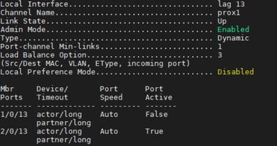

I have 2 m4300-12x12f in stack.
It was working great no problems at all.
Port 1/0/13 and port 2/0/13 lag configuration Hash mode 3 both ports Active.

Investigating further only port from switch 2 are active in a Lag groep
Added a Test server connected it to switch one, my laptop to switch two, they can communicate.
When creating a new lag interface always switch port on switch one will not get active.
Disconnecting port on switch 2, link in switch one will not go active.
I am out of option right now hope someone as a eureka moment 😉
  • Still don`t know why it took so long to form a Stack again, after the power cut.
    All port channels seem to have jumped to "Static Mode Disable" Turning it back on Enabeld.
    Fixt my problem
