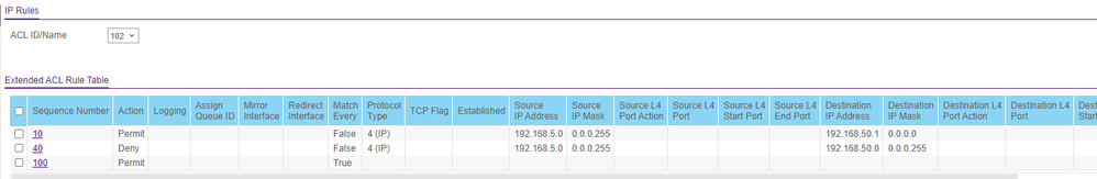

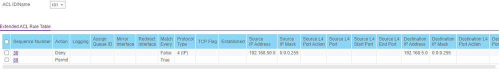

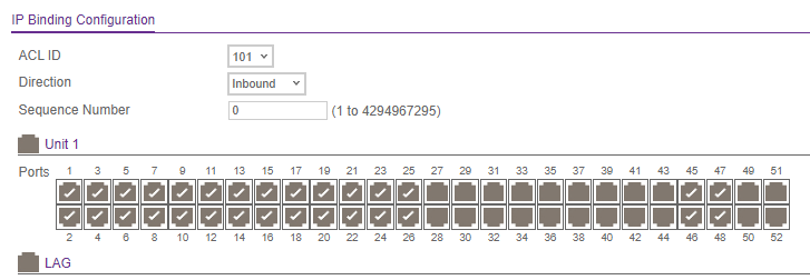

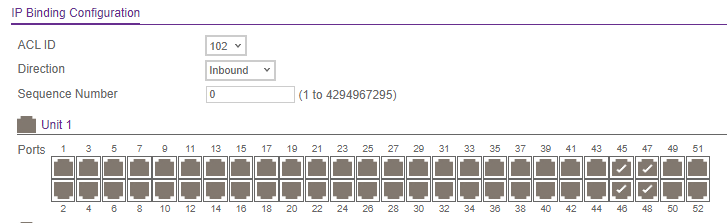

ACLs setup
After implementing these configurations, clients belonging to different VLANs can still ping each other, which is not the behaviour I expected. I would have anticipated the ping to fail.
Any advice on how to set up the VLANs and apply the necessary ACLs would be greatly appreciated. Thank you in advance for your help!
- Strangely, the ACLs rules functioned correctly after saving the configuration file, resetting the switch, and subsequently reloading the saved configuration file.
