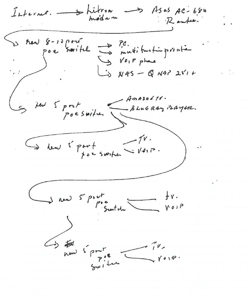

    • jjesson's avatar
      jjesson
      The above is crude network sketch. My biggest question is when you are mixing poe and non poe assignments how do you control the ports (ie I assume you can't have a poe port to a non poe appliance). I also don't know understand if the down stream switches get their power from the first switch or do they need individual ac outlets for power. I would like some flexibility to in terms of future expansion and I don't no whether those devices will poe or non poe. Any assistance would be greatly appreciated.

        jjesson,
        As per checking in here that you do need 1 8-10 port POE Switch and 4 5-port POE switch. May I know if you wanted those switch to be managed or just a plug and play unit? I suggest for the 8-10 port switch is the GS110TP and for the 5 port switch is GS105PE.
