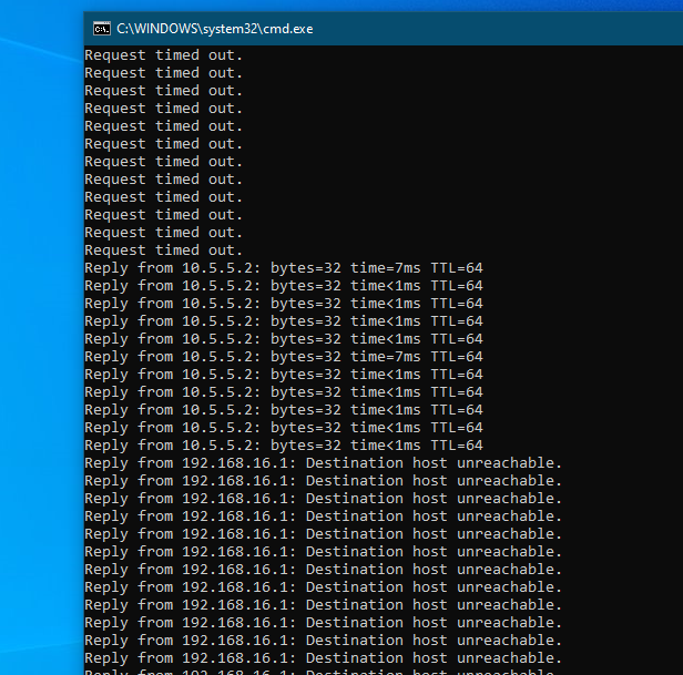

I should add that I can reach the VLAN configured on the USG-Pro, I get ping replies from 10.5.5.1 which is the router. But the same isn't true for any other device on the 10.5.5.0/24 range.
- djmohrDec 17, 2020Aspirant
I'm getting strange results when switching between Tagged and Untagged for VLAN.
The above screen happens when I change the ports from Tagged to Untagged for VLAN 2. Switching back to Tagged just results in a Request timed out.
- schumakuDec 17, 2020Guru - Experienced User
That's why i had proposed to configure two access ports into each VLAN - this allows to figure out if the VLAN config of the router and the switch VLANs are workable. A test computer plugged to each port must get an IP from the relevant VLAN and iP subnet / DHCP server, and must be able to ping each subnet default gateway.
