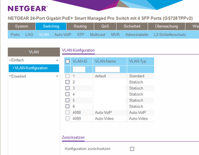

    I have configured the VLANs on the Netgear Switch analogously to the VLANs on the Edge Switches (1-6, with 1 being the default).
    I have also entered the port memberships. PVID remains 1 for all ports.

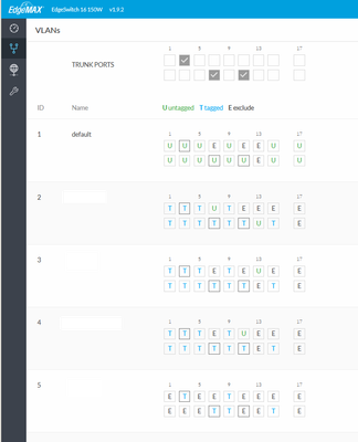

    On the Edge Switches, the ports for the Access Points are configured as follows:
    Trunk Port, untagged default VLAN 1, tagged for all other VLANs (works smoothly).

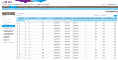

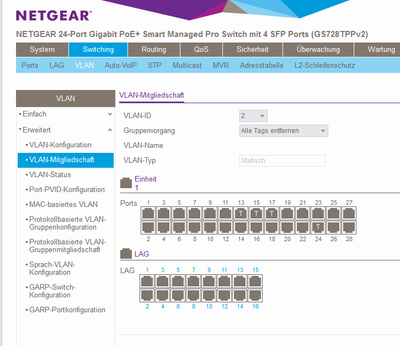

    However, no matter what combination I try on the Netgear, I can't establish a connection to the outside.
    The network adapter on my computer just receives an APIPA addresses.

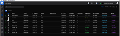

    However, the Access Points can communicate with the controller and are displayed there (same subnet).
    If I connect the Access Points to one of the Edge-Switches, they do work perfectly.
    So, the problem is most likely buried somewhere in the configuration of the Netgear switch.

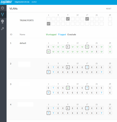

    The configuration of the Edge Switches is as shown below:
    Switch Number 3: Port 3 and 8 are Access Points.
    Switch Number 4: Port 17 is the trunk Port to the Netgear Switch
    If anyone has an idea, I would be very grateful.

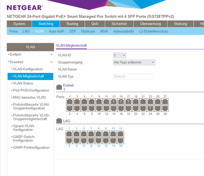

        Thank you for your answer. But I tried that already, as this was the working configuration on the other switches.
        I will spare you the screenshots of more Ts and Us.
        But out of sheer desperation I went back to the basement and tried (not that i didn`t do that already last week):
        On all VLANs but the default one, which i left untagged.
        Trunk port tagged, uplink ports tagged
        Trunk port tagged, uplink ports untagged
        Trunk port untagged, uplink ports tagged
        Trunk port untagged, uplink port utagged.
        Nothing worked.
        There has to be something else, that i am missing.
