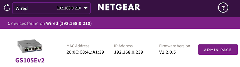

All right, my first guess was wrong - this looks like an initial or very early GS105Ev2" switch 8-)
From how I read the initial firmware 1.2.0.5 had no Web UI - it was added with GS105Ev2 Firmware Version 1.3.0.1 :
===New Features & Enhancements:
- Supports Web GUI management.
Using the Download Link below, download and extract the new firmware to a convenient place such as your desktop. The filename after extracting is GS105Ev2_V1.3.0.1.bin

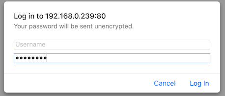

> Does your switch show a Netgear branded and designed login form (probably not), or a browser side basic auth pop-up (probably not), or does it come up with a either an empty page (most likely)?
It shows nothing as it prompts for authentication first.
> Does the Netgear Switch Discovery Tool show a firmware version like v5.4.0.3?
No, the reported FW is 1.2.0.5

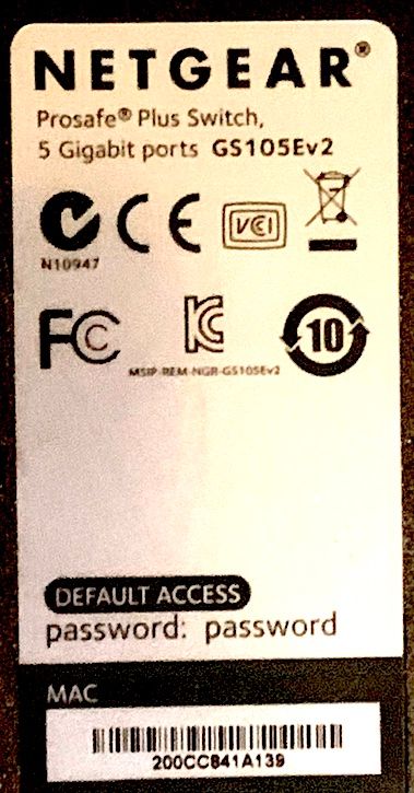

The sticker on the back reports:
NETGEAR
ProSafe (c) Plus Switch
5 Gigagit ports GS105Ev2
(FCC/CE, etc logos)
MSIP-REM-NGR-GS105Ev2
DEFAULT ACCCESS
password: password
MAC: 200CC841A1239
Serial: 3MX1435ED00470
Made in China 272-12044-01

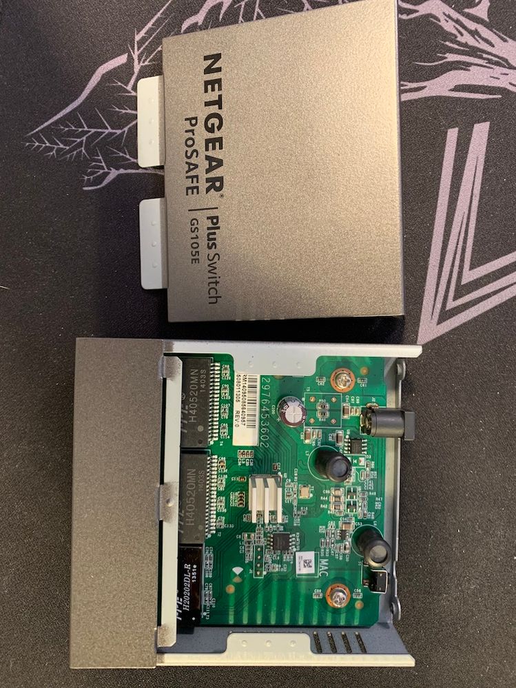

The PCB as a silk white marking: 2976453602
and a couple of sticker. One with the MAC address as a datamatrix (same as on the back sticker)
The other sticker contains a barcode with
RM14095085640957
5508011305 REV:0
On the bottom side of the PCB, there are additional silk white markings:
SH1 94V-0
E248779
135101
