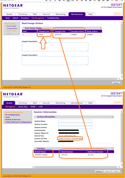

Can't download or boot into latest firmware image on GS724Tv3
I'm trying to repurpose a GS724T v3, and it's not going like any other Netgear switch I've ever seen.
I'm hitting two issues. First, I've gone to the usual "HTTP download", selected the latest ...

Thanks. As it happens, that would have been useful to know, before I carried on trying to get it to work and ended up bricking it. Result, one non booting switch, LEDs light up, orange power LED, nothing else.
I belatedly see from the forum, that this has been a known problem for ages, and bricked many people's routers. The reason for this is probably related to Netgear omitting all mention of this known issue and the precautions needed, in the firmware release notes where Netgear directs owners on the correct way to update firmware.
So I'm now in the same boat as many others. Fortunately I already have a Prolific USB to serial cable/adapter. (It's quicker to self-fix really). I seem to have a good serial link, but I'm stuck now, because I'm getting consistent and identical gibberish at switch bootup. However, there are so many threads by owners of bricked switches, that the solution also seems to be on these forums - apparently one needs an RS232 TTL converter, not just a "usual" USB to RS232 converter?
