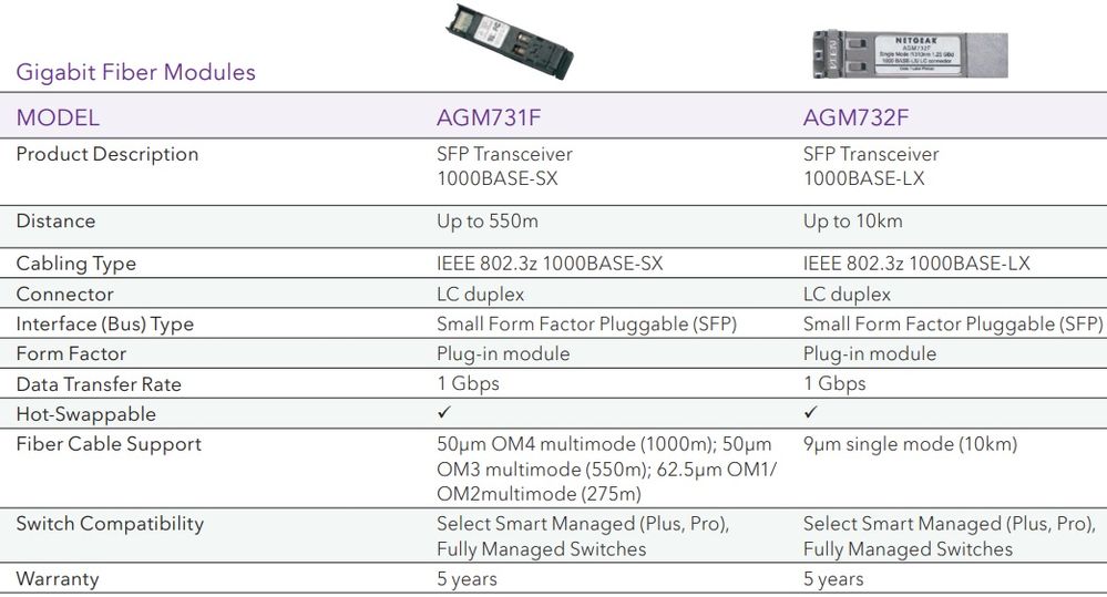

    The SFP modules that are compatible to both GS728TPP and GS752TX are the AGM731F and AGM732F.  Kindly refer below:

      So I need one of each of these modules to make these 2 switches connect? What cable would I use between them?
      You will only need either the AGM731F or AGM732F.  You can use any 1Gbps Direct Attach Cable.
