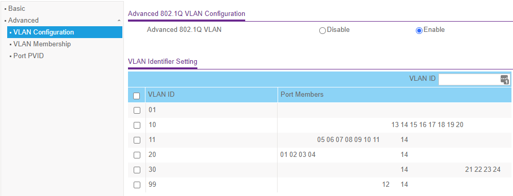

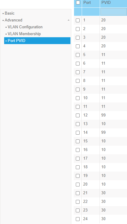

I'm trying to get multiple VLANs to connect out to the internet through a JGS524PE without success so far.  I set up the following VLAN configuration.  Port 14 is tagged and is connected to the router.  All others are untagged.  When I enter this config everything loses internet connectivity.  Any ideas?
PVIDs are

    What exactly do you want to achieve?
    Your set-up is an appropriate 802.1q confguration for multiple networks. You have five individual networks, where each needs it's own IP subnet, it's own DHCP server, it's dedicated default gateway IP address - what would be done on a router supporting five dedicated networks based on the tags.
    Consumer routers and typical ISP CPE routers don't support such a configuration.

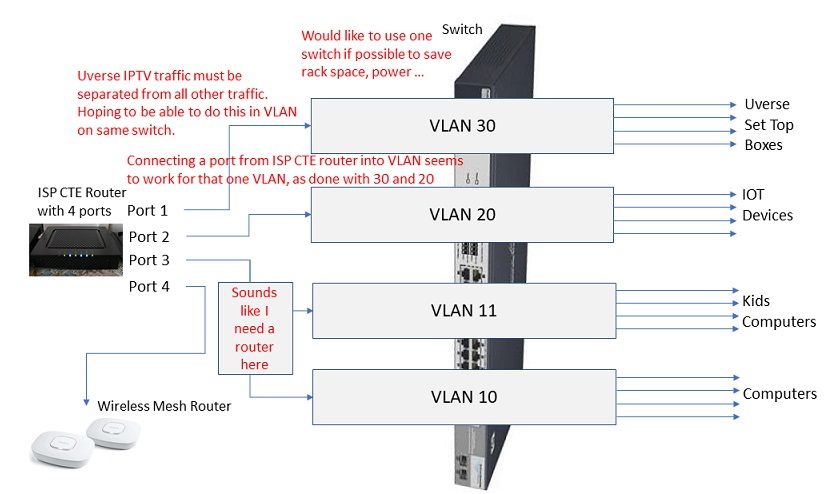

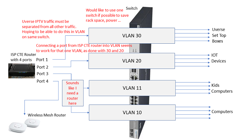

    • NetworkN00b2021's avatar
      NetworkN00b2021
      This is what I'm trying to achieve.  Other posts indicated a router on a stick or VLANs with shared Internet access via static routes options.
        NetworkN00b2021
