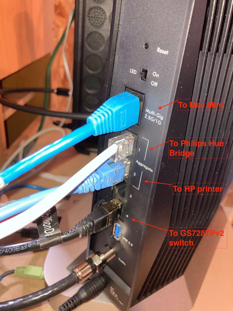

Okay, so going back to what you said about the possiblity of poor wiring, take a look at this photo of the back of the CAX80. I made a straightforward mistake.
Note that the black cat8 cable running from the CAX80 to the switch is 100 ft long. The blue cat5e cable running from the CAX80 to the Mac mini is only a couple feet long, and the Mac Mini does not support multi-gig ethernet...so I switched out the cables, putting the black cat8 cable in the multi-gig port and the cat5e for the Mac Mini in port 3.
And voila! I can now seemlessly without delay log in to the GS728TPv2 GUI from my browser on my MBP and on my ipad. The GS728TPv2 also now shows up on the CAX80's list of connected devices! And there are no request time outs when I ping the switch!
