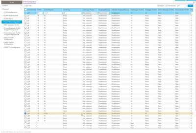

I have a netgear managed switch (GS752TPv2) with different VLANs.
On one port I do want to have two VLANs, one untagged (VLAN 10) and one tagged (VLAN 40).
The untagged is used by a physical notebook, the tagged on is used by a VM running on the physical notebook.
So far everything seems to work - only strange issue: My monitoring system starts sending me alerts regarding to network input errors on my hypervisor network card (which should even not be part of this traffic) as soon as the computer is connected to the port... So I guess there must be some packets wrongly deliviered...
What is the correct way to combine an untagged and tagged vlan on the same port?

    Port g41 looks about right, untagged access port for VLAN 10, tagged trunk for VLAN 40.
    Tell us a little bit more about the config of this VM nd the host for example. Also what is the source of the packets in question, and why these could end up in the wrong VLAN.... Looks more like a config issue on that VM host and VM itself.
