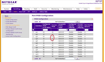

"Current PVID" auto turns to ZERO
I have a Netgear XS712T 10GbE switch as my main switch off my router. I have a couple VLANs going for Management, Main Network, Guests, etc. Off this XS712T, I have a ProSafe GS750E switch that I'v...

For the LAGs, you must configure tagging and PVID on the LAG, not on the individual ports. The Current PVID on the ports will always show 0 as long as the ports are member of a LAG. SImilar for the LAG VLAN association for T or U - do it on the LAG level. On the PVID settings, open "LAG" or "all" - there you can configure the l1..l8 PVID.
