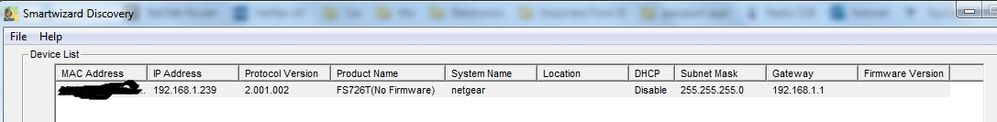

Well, I finally got it.
Thanks for suggesting Smartwizard Discovery, that's the one that finally did discover the switch and it identifies as FS726T (no firmware)
So now I'm of to find the appropriate firmware and hopefully it works after that.
Thank you all that tried to help and got me on the right path 👍👍FS726T
