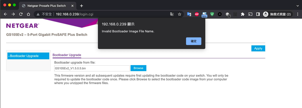

My GS105Ev2 when I do factory default and access 192.168.0.239 page, will only ask me to upgrade bootloader, no other page can selected
The page prompt message:
Bootloader upgrade from file:
[ ] Browser
This firmware version and all subsequent updates require first updating the bootloader code on your switch. You will only be required to update the bootloader code once. Please click Browse to select the bootloader code image from your computer where you unzipped the firmware files.
I tried to upload the firmware, of course it can't be updated normally

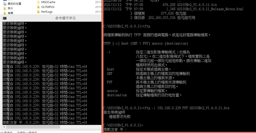

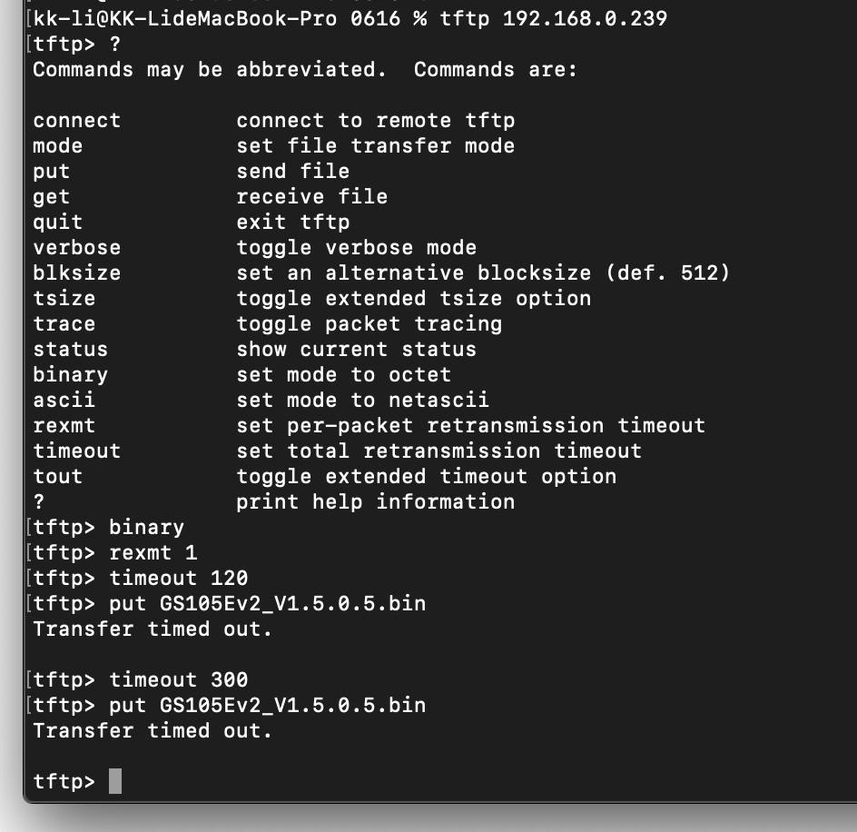

At the same time, I tried to use the tftp command and the tftp tool of windows, but I couldn't update the firmware by this method.
He will show timeout only

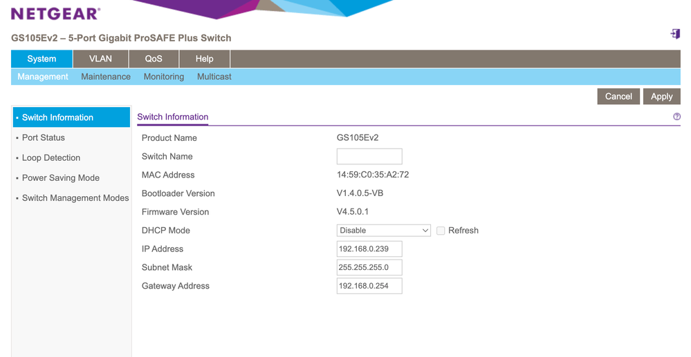

    Let me answer my own questions.... I downloaded the zip file of the old firmware (v1.5.0), found the bootloader file in it and tried to upload it, and finally used v1.4.0.5-VB to successfully update and enter the management page
