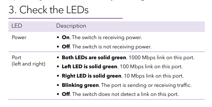

Beyond of what plemans already suggested, I like to work a little bit with your troubleshooting capabilities.
Each "cable" resp. the connection between the switch and the router, switch and PC, witch and each other devices does make up an Ethernet link. The status can be seen on the end points usually, typically there are LEDs on the router, each switch port, and each connected device. A good point to start are the LEDs on each connected Ethernet ort on the switch:
Yes, this is a part borrowed from the 5-Port and 8-Port Gigabit Ethernet Unmanaged Switch models GS105v5 and GS108v4 Installation Guide, it certainly came with your switch, and it's available GS108v4 Support Pages
What do the relevant LEDs - for the connection to the router, and for the connection to you PC- either while it briefly work, and then when it's cutting out - show us?
Check your computer and the router manufacturer documentation.
This should help identify what is going wrong in a little bit more detail - beyond the fact the PC can't get Internet access.
